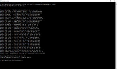

That said, how do you know which WS to remove from?
I wrote a utility that will remove all objects from workspace given the WS. It works great but if you don't want any user interaction there needs to be some logic to determine which WS to remove the objects from.
The utility can be triggered anyway that's required. Below I ran it in a Windchill shell.

Zoli,
The code was not complex, particularly if it's always the same WS.
An understanding of how things work in the dB and a little knowledge of Java is all you need.
The code can be run automatically by setting up Schedule Queue entry that automatically runs the code at regular intervals (once a week maybe) that would not conflict with the running of the 3rd party tool.
I use this technique for any maintenance that should be done on a regular basis such as removing unreferenced files or cleaning out publishing queue.
Or perhaps hook it to your script to run before the script does the download or after the job is done.
