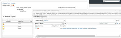

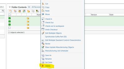

Select the folders to delete and use delete action
some objects lay not be deleted if refenced somewhere in DB for data integrity  :
Fede
What you might want to do is move all the data to a single folder for what you want to delete. Then you can delete the folders that are empty. As @Fadel mentioned, as long as the data in that folder has no references to things outside it, it should safely delete but you might have to spend a few cycles deleting in chunks until its all gone. How many objects are there in total? Another good strategy is to delete by object type first. What sets of object types do you have in this mix?
