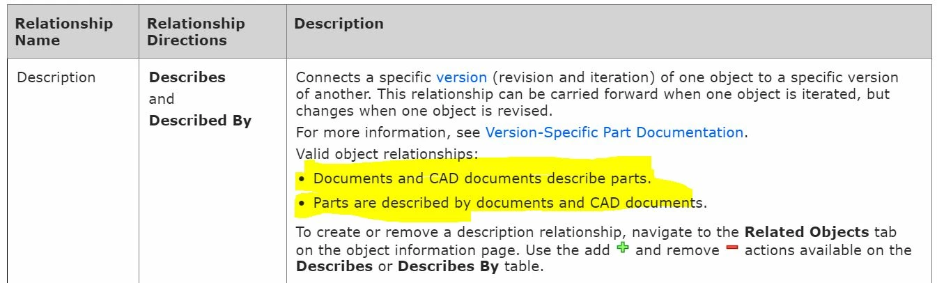

Is it possible to add CAD Documents in the 'Description' relationship? The help center suggests so.
https://support.ptc.com/help/wnc/r12.0.2.0/en/#page/Windchill_Help_Center%2FObjectOviewObjectRelationships.html%23

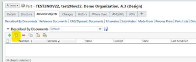

However, we could only create/search for WTDocs in the described by table of a part.
Any insights will be helpful

I am however trying to understand the reference of the CAD(EPM) documents in the Description relationship details in help center.
https://support.ptc.com/help/wnc/r12.0.2.0/en/?_gl=1*o9e91n*_ga*MjE0MjU1MDM0MC4xNjg3Mjc1Mjc0*_ga_7NMP2MSYPM*MTcwMDY3MDgyOS42NC4xLjE3MDA2NzM2NDMuNDEuMC4w*_ga_1QBT6P6HR1*MTcwMDY3MzYyNC4xMjkuMS4xNzAwNjczNjQzLjQxLjAuMA..#page/Windchill_Help_Center%2FObjectOviewObjectRelationships.html%23

this an issue with the help center , kindly open a support case , one of my colleagues will raise a documentation  SPR to correct it .

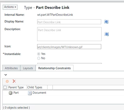

even on that table the insert new is offing only WTDoc, and if you try to customize the table view , you will see only
WTdoc and its subtypes
