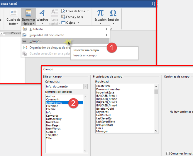

I always use Word function "Quick Parts" to show Windchill attributes in MS Word.
It is much more stable and powerfull.
Microsoft also is using Quick Parts for Sharepoint attributes 😉
@jvonzastrow1
When I use "Quick Parts" I do not see the attributes from Windchill.  Do I need to do something to create them? I was reading some of the limitations based on CS194304 and it looks like Quick Parts do not auto update on open but need to be refreshed.
If you want to use as Quick Parts, then instead of document properties, you need to select Field > docProperty and you will see all Windchill properties there:
