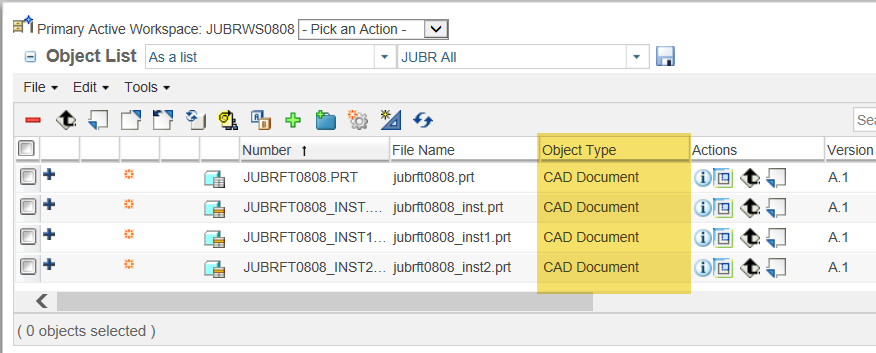

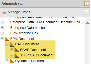

Spoke with a colleague who had experience with a customer having this issue. The reason for it was that the expected soft type of CAD Document which has the mentioned attribute was not being created for instances. I recommend you check setting of preference Operation > Upload Operation > Upload > Soft Type Parameter and if that parameter is set in CAD Documents as well as Windchill/codebase/EPMDefaultSoftType.xml per article CS160454. Also, add the Object Type column to the workspace view to see if they are the expected type when checked against Type and Attributes Management. If you require further assistance, I recommend that you open a case with PTC Technical Support.

Thing is... the generic and all the instances are already check-in in Windchill. After a modification of the generic, Windchill starts complaining about the IBA definitions.
Are those attributes being checked each time we upload a modified generic?
