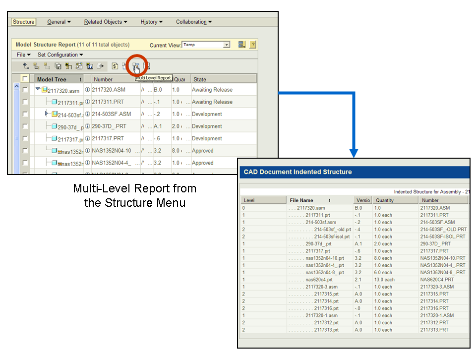

One final thing that might help... for the BOM, I have a couple of tips here. First, go to the Structure menu and expand the entire BOM. Export the result to a CSV file using File->Export to CSV. This will open the BOM structure in Excel (at least it should if Excel is set as the default for CSV files). You can then process the BOM further in Excel.
A second idea is to get to the Structure menu and use the multi-level report button which gives you an indented list as shown below:
