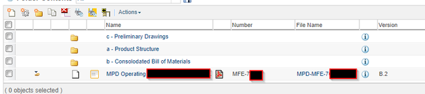

a move action allows chose different folder  with following setting in the wizard
