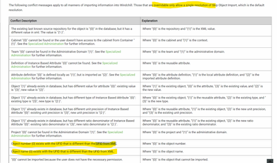

Hi @RK_10391651
Have you try to export and import options and variants from one windchill instance to another?
if so you need to identify the com.ptc.windchill.option.model.ChoiceMaster with UFID and check what is in your system. There can be another one with different ID and you need to change the source file.

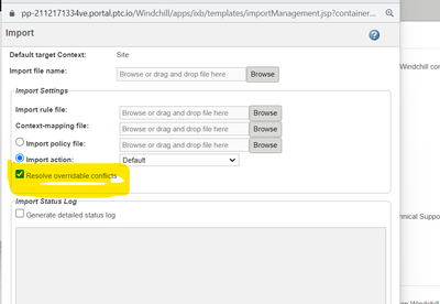

Hello @Fadel ,
Thank you for your response, But somehow i am missing how to apply the solution, if this is overridable conflicts - YES.
Also if we want to use some RULE for import , Do you have example template if yes please share ...

This is how override the conflicts
