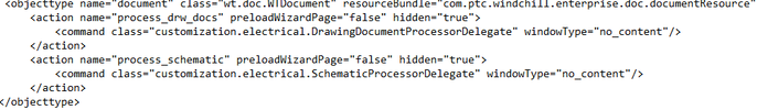

Can you elaborate a bit more on the customization? Is this something that PTC has guidance on or did you have a PTC partner perform the customization for you?
avillanueva
23-Emerald I
(To:Aaronm87)
It was modification we created using standard customization practices for the create and edit wizard. Two actions were added that were mapped to new custom delegates.
The delegates only process if the soft-types are mapped right. This is where we stuck the custom logic. The steps in the UI are not visible.
