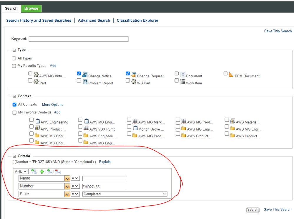

As I mentioned in my request for help that I'm not an administrator, am a user, and I don't have access to create this program.
I can do Advance Search. See the snapshot below.

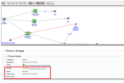

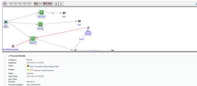

I see this is already marked resolve but though I'd add to it.
There is a way to restart an existing terminated workflow.
The upside of restarting an existing workflow of course is that you keep all the workflow info that has been already stored (with the exception of data that is stored in the Work Item) and you pick up the workflow right where you were when it was terminated.
I made a test workflow and terminated it from the OOTB Process Manager.
Before Terminate
After Terminate
I then wrote and ran some code in a Windchill shell to restart it.
It did take three tries to get the code right but it works.
After Restart
Note the Start Time is the same in all images.
Where as this is suppose to correct an inadvertent termination I decided not to update the workflow's original Start Time. Although updating Start Time is doable.
Note the End Time is updated in the images.
