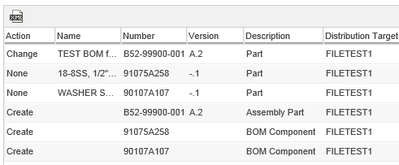

So, learned something interesting. You can use the "Send to Distribution Target" to preview what ESI will do. In this case, I created a test BOM and a new view version (MFG) and sent that to the DT. Next I created an new version A and also its corresponding MFG view. If I try to send the A MFG view of this assembly, it shows it as a "create" for the Assembly Part:
Why would it not see this as a change since I did change the BOM and its been revised?

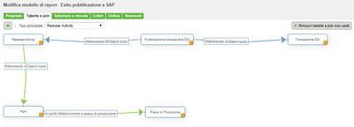

Hi Antonio,
depending on your ERP system, and how you have "connected" Windchill with your ERP (in my case SAP with Tibco as a middleware) you receive info (in my case through SAP BAPI) if you are creating or modifying a BOM.
When I call Tibco from Windchill, you can see info as in above image, but you have to tell Tibco to call a BAPI to create or to modify (maintain) a BOM.
Marco
You can also see, through a query  builder report, in real time the state of objects sent to ERP (see image)
Sorry for some Italian label
Marco

Have you set the View to BOM type preference, e.g. Design=Design and MFG=Production?
That can lead to this behavior, as they are typically two different objects at the BOM header level in the DT.
