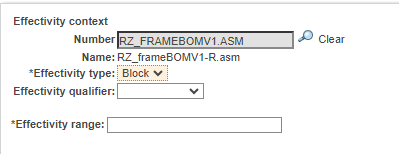

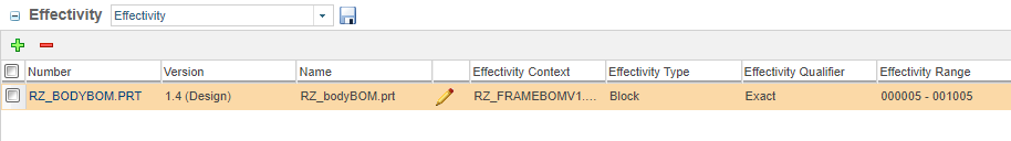

You don't have to create new subtype of effectivity,
You just need to set the WTPart to Serial number traceable.
Then you can set the effectivity type to Lot or Block
Do not forget to assign a context assembly that is traced
CS59673 - ow to change effectivity type of resulting object of change activity to "Serial Number" in Windchill PDMLink
