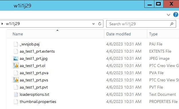

The windchill system (application, sql and publisher) had to be restored last week from a Veeam backup by Corporate IT.  Since the restore I have not made changes to the system.  As a test I tried creating a simple drawing on a current format.  During checkin here is what I see in the worker temp file:
To further complicate matters, in rare cases the pdf file will publish, but I so far I don't see any pattern for these rare occurrences.
Was anything reported in the Creo trail file or .out files?  If its a sometimes issue, that sounds less like a configuration setup issue. If it was that, it would work consistently or not work at all.  You can also try running in foreground mode where you can see Creo operating. There is also additional debug logging that can be enabled. There should be a file in worker folder with debug options.
