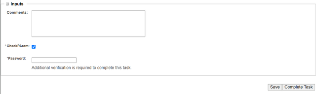

Just need to verify if this is a bug or not, to compare to another system. Noticed on my upgraded system that the esignature password field which used to be below "password" is not thrown to the right. My 11.1 system has it on the left. Not a huge deal, likely a CSS issue but can't see why it would be done this way. What does your 12 system show?

btw if you use Template View for tasks (configured in Preference Manager) then the password filed is on the right side >D

In my case the password field is located on the left side

Thanks for confirming. Now to hunt down the cause.

I am. Hope to not one day. That explains it.
