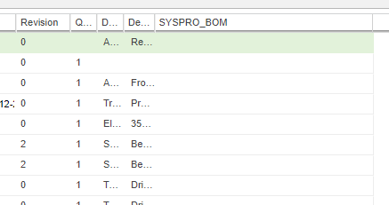

The attribute/parameter is now available in Windchill, but after I set the value to yes/no for a few different components in an assembly, checked the assembly back into Windchill, nothing shows in the table:
Any ideas on what I did wrong?

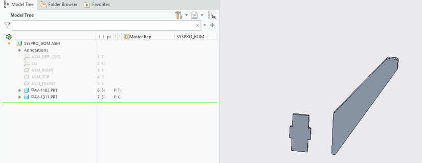

Figured I would run a test and share the pics of the steps I'm taking to make sure I'm not doing something incorrectly.
New test asm, brought in 2 parts:

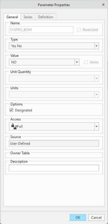

I click in the (highlighted blue) cell for "SYSPRO_BOM" parameter. Parameter properties window opens. Here's the defaults:
Parameter properties, after I make the changes I want:

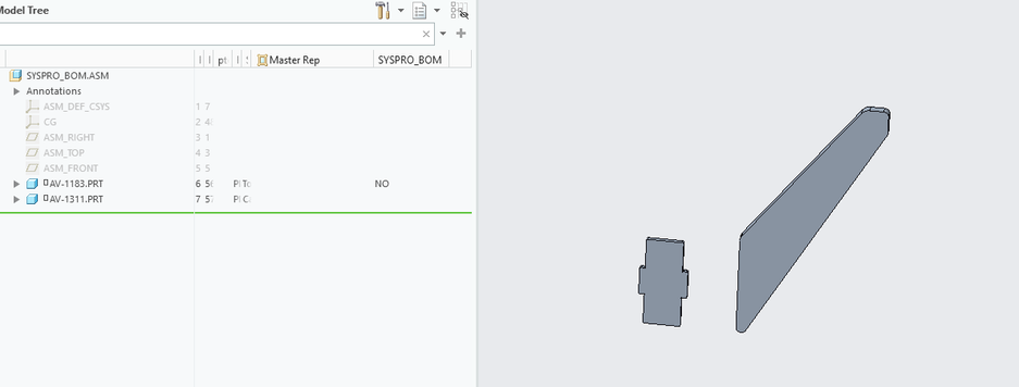

Model tree shows the parameter value "NO":

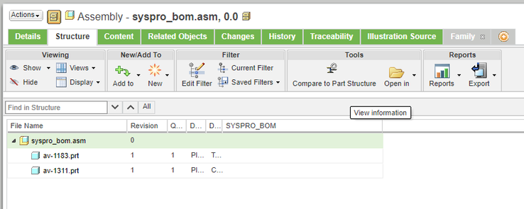

Check in:
Nothing shows up in Windchill:

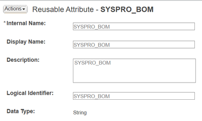

I think I see the issue.. you set the Windchill attribute to String, but in Creo, it's "Yes/No". So change Windchill to be a boolean. I don't think you can change the type. You'll probably need to delete it and recreate it.
Matt_C
(To:joe_morton)
Good catch! That was partly the issue. I also had added the attribute under Type CAD Document instead of Type CAD Document Uses Link... didn't realize the difference there. After making both of those changes it seems to be working now.
