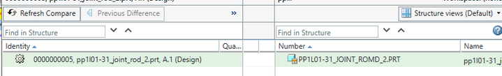

Use Case: If you perform a Part to Part BOM Compare, you can export the table to Excel. If you perform a CAD to Part BOM Compare the export option is not available.
Description:
Does anyone know if the export menus can be added to the CAD to Part Compare?

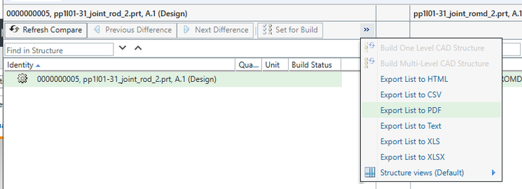

Hi @MM_10260548
You can try to add the export menu to the comparation menu.
just change a customActionModel.xml file . You have to find correct element to change and add a row for the export menu
just add the following rows
xml file is located in codebase\config\actions\customActionModel.xml

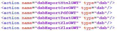

	<action name="dsbExportHtmlGWT" type="dsb"/>
	<action name="dsbExportCsvGWT" type="dsb"/>
	<action name="dsbExportPdfGWT" type="dsb"/>
	<action name="dsbExportTextGWT" type="dsb"/>
	<action name="dsbExportXlsGWT" type="dsb"/>
	<action name="dsbExportXlsxGWT" type="dsb"/>

PS: it is not ideal, it can throw some errors if the wtpart does not have linked cad but it works.

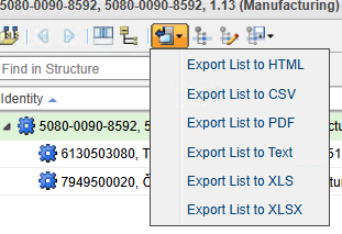

@HelesicPetr, will this work on the Part2Part compare also or do I need to look for another model in place of
<model name="dsvp2cPartTreeToolBar">
Hi @BrianToussaint
Actually I took the model(export function) from the PartToPart comparation wizard 😄
PetrH
