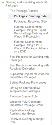

Is it possible to export a creo part (.prt) file and or assembly (.asm) file from windchill "server A" to import the same files into "server B"?
2 REPLIES 2
HelesicPetr
(To:AQ_10299550)
Hi @AQ_10299550
It is not so easy and straight forward but you can use
Export/Import utility on a context. from a utility
You just need same configuration on both sides.
or Packages to exchange the data from server to server. But for that you need a licence.
Sending and Receiving Windchill Packages
Sending Side
Receiving Side
Windchill PLM Connector Importable Package Group
read all paragraphs
