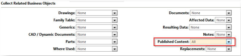

  1. Ensure CAD Document drawings are directly added to package and/or gathered by the package collection
  2. The package collection rules are configured to include published content (i.e. PDF drawings)15-39-31_Bulk Export of PDF Drawings from Windchill (eg all drawings in product) - Windch.png

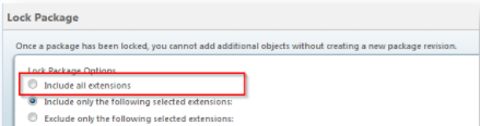

If you only want the PDF drawings files in the zip (without the CAD models and CAD drawing) then select to include only files with .PDF extension when locking the package.
15-41-06_Bulk Export of PDF Drawings from Windchill (eg all drawings in product) - Windch.png

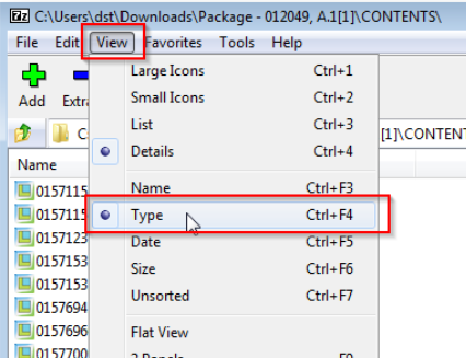

Unfortunately when you create a .ZIP from a package deliverable, each of the drawing representations is added to the package in CreoView format, which has the file type .PVZ. A .PVZ is actually just another kind of zip file which contains the actual .PDF file you want, plus a bunch of other things that only CreoView can make use of. Put simply, a package .ZIP is actually a zip for full of zips!!! (each sub .zip or rather .pvz containing one .PDF file)
Thankfully you don't have unzip each .PVZ one by one, you can you use the free 7zip program to unzip all the .PVZ files in a single action.
  • Ensure you have 7zip installed on you computer
  • Use 7Zip to open the CONTENTS folder in the package .ZIP
  • Change the view to sort by type
15-42-21_Bulk Export of PDF Drawings from Windchill (eg all drawings in product) - Windch.png

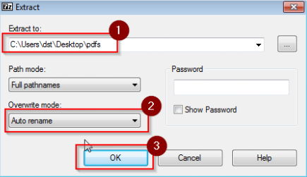

  • Select all the .PVZ files
  • Select EXTRACT
  • Set the target folder
  • Set Overwrite mode to Auto rename15-43-31_Bulk Export of PDF Drawings from Windchill (eg all drawings in product) - Windch.png
