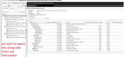

Export structure report with Cad documents? Including level information? Multi-level report
Ritpd
Version: Windchill 13.0
Use Case: How to export structure report with cad documents? Including level information? Multi-level report. If it is via custom table builder with custom action . Guide me how to achieve this. If you have any implementation , it would be great if you can share?

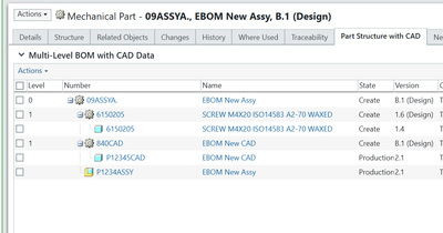

I am able to achieve it using custom tree builder and added a export action.

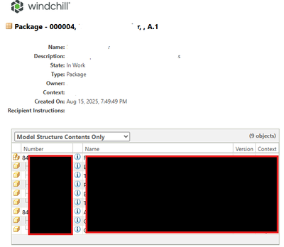

Sound like you'd need to go the route of packages to do this. When done, it'll create a standalone browser with all your CAD collaterals (or whatever files you chose) in a zip or series of zip files. The standalone browser that comes in the zip file gives you the structure view with the CAD data in the content folder of the zip.
