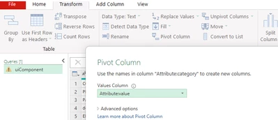

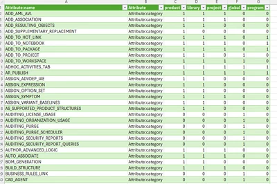

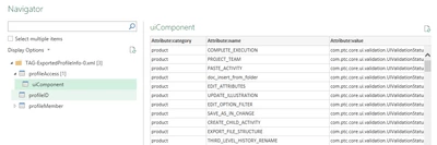

If you import the XML file into Excel you can get something that looks like this.
get data from file xml.
Transform> Pivot Column

I would like an easy way to view the Standard profiles.  The XML file doesn't give a clean view of the profiles as you have to manipulate the data to get the results.
Thank you for providing this solution.
