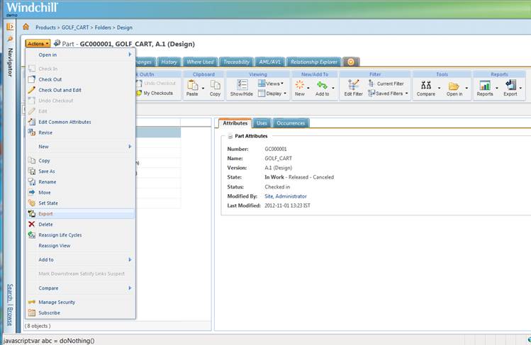

https://www.ptc.com/appserver/cs/view/solution.jsp?n=CS112369&posno=2&q=bom
https://www.ptc.com/images/cs/articles/2013/01/20225346_ovas.jpg
But I don't have that option in my Windchill? What am I missing here?
Screen of my windchill to compare:
No one, anyone?
On your screenshot above I can see you are looking at the CAD Document structure (your Creo assembly and part structure). The documentation you refer to e.g. https://www.ptc.com/images/cs/articles/2013/01/20225346_ovas.jpg is about the Part Structure. Parts and CAD Documents are different object types that you can use to form two parallel structures in Windchill.
The reason for having both Parts and CAD Documents is that they serve different purpose. CAD Documents focus on you Creo modelling of the products and the responsibility of the Parts is to reflect your complete BOM. This gives you the freedom to not model everything in CAD e.g. glue etc that you still need to account for in your BOM.
There is an auto-associate button in your workspace to easily create Parts in a 1-to-1 fashion from your CAD objects.
You do not specify which Windchill version you are on. I think Parts are not available in the recently introduced 'Windchill Essentials' edition. Also availability of features is of course subject to how access rights is set up in your local environment.
