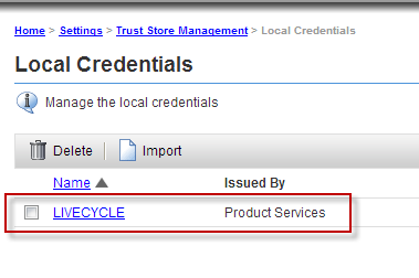

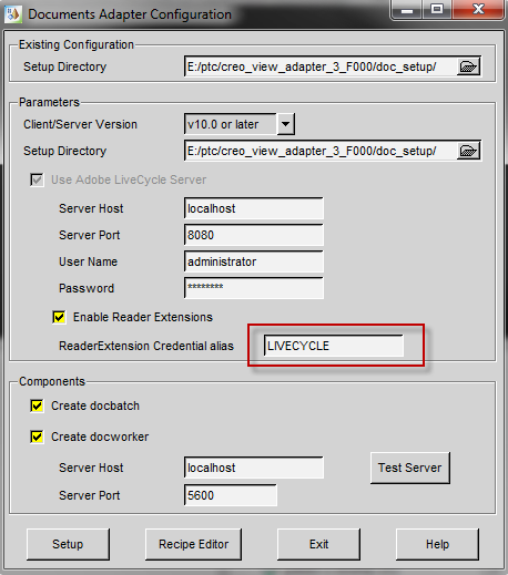

Refer Article and steps: https://www.ptc.com/en/support/article?n=CS150853&language=en&posno=1&q=Failed%20to%20enable%20pdf%20commenting&source=search
