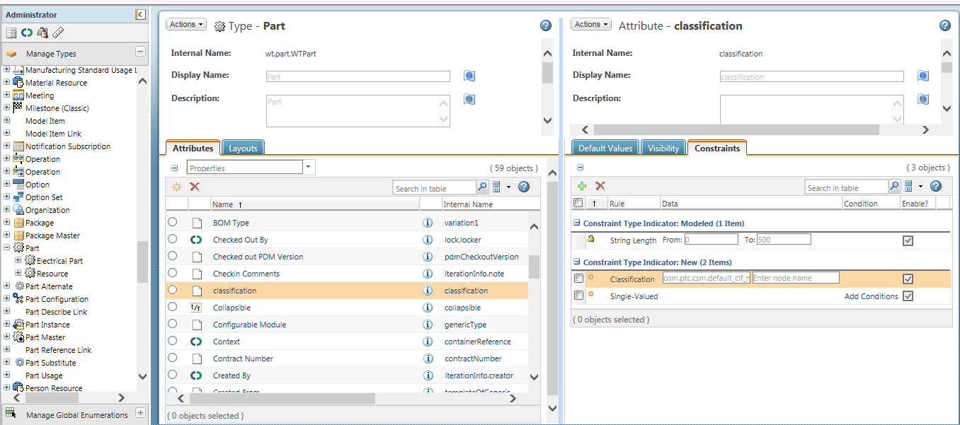

Here in classification tab find option ins not found

And are you sure you set up the binding attribute correctly using the com.ptc.csm.default_clf_namespace constraint:
http://support.ptc.com/cs/help/windchill_hc/wc110_hc/WCClassAdmin_DefineClassBindingAttr.html
dchavan-2
(To:CaitlinWheeless)
I am binding attribute correctly pl check snap
