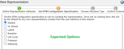

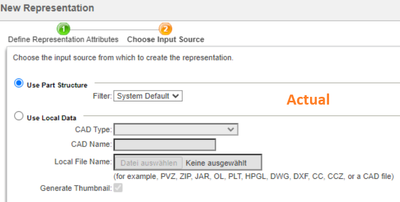

2. When attempting to create a new representation for WT Part, the page 2 "Choose Input source" of "New Representation" dialog box  shows different options than expected. As shown in the images below...
