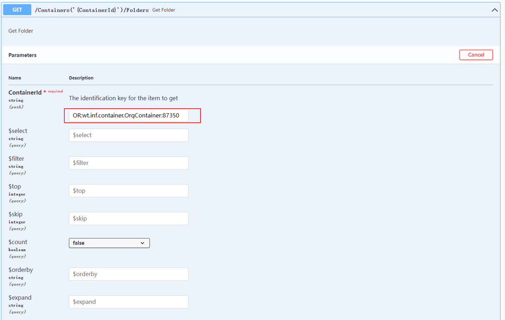

How do I get the folder ID? Right now I am trying to use the Windchill REST Services site where it generates the request and response for you. I assume that under the data administration domain you can get folders from a container using /Containers{'ContainerID'}'/Folders but it seems like none of the folders show up when I provide the ContainerID for an organization. Windchill Version 12.1.2.0 and REST API 2.5

Hello @VH_10947268
Is there an issue with the input parameters?
ContainerID should be like OR:wt.inf.container.OrgContainer:123456789
It works on my server

Thanks for responses, @Rocket_Max @HelesicPetr
I’m not sure what a FolderID is exactly supposed to look like, but what I’m guessing is that if I have folders in a organization, I can provide the organization’s ContainerID and get all the folders’ IDs inside that organization. I’m not exactly sure what a Cabinet is, but maybe that is the FolderID? But I have multiple folders in that container and only one CabinetID shows up so I’m guessing not. Maybe I need to get folders as use the cabinetID as the container? I’m trying to figure out this because you can provide Folder@odata.bind in the API when creating documents, and I’m guessing it will create a document at that folder.

It looks that the get method /Containers('{ContainerId}')/Folders, Get Folder send back only Cabinet,
But I cannot find the way to get the subfolder ID
