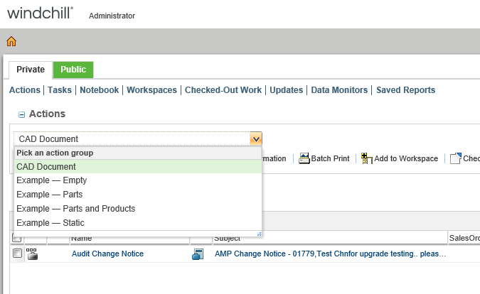

Does anyone know how to hide the example action groups supplied with Windchill 11 M030.
1 ACCEPTED SOLUTION
This is a little bit strange programmed from PTC. As soon you have the "Client Customization" enabled in the preference, the 4 Examples are displayed. As soon you hide it, those 4 examples won't show up anymore.
There is also a xconf where you can delete the examples, but it's not really necessary.

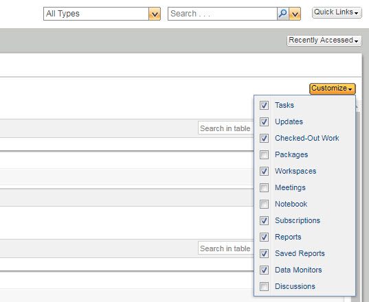

@GregOlson,
Isn't Actions appearing in the Customize drop-down menu on the right side of the page?  I don't have it in mine because maybe you have some different module installed that I don't have??
GregOlson
(To:BenPerry)
Ben,
Yes you can hide the table...what I want to do is keep the table.  I have created a custom action group (CAD Documents), and what to hide the 4 examples that came with the software.
