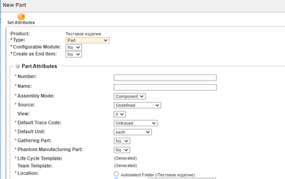

Hello everyone, can you please tell me how can I add a prefix to an autogenerated number?
How to get this number: ABC.000_018_5268?
<AttributeValues objType="wt.part.WTPart">
	<AttrConstraint id="number" algorithm="com.ptc.core.rule.server.impl.GatherAttributeConstraints">
		<Value algorithm="com.ptc.core.rule.server.impl.GetServerAssignedConstraint"/>
	</AttrConstraint>
</AttributeValues>

   ,thank you very much for the quick response. I added your code, but now the number is no generated automatically
	<AttrValue id="number" algorithm="com.ptc.windchill.enterprise.revisionControlled.server.impl.NumberGenerator">
		<Arg>ABC</Arg>
		<Arg>{GEN:wt.enterprise.SequenceGenerator:PROMOTIONNOTICEID_seq:7:0}</Arg>
	</AttrValue>
</AttributeValues>

, nothing has changed
		<Value algorithm="wt.rule.algorithm.BooleanBranch">
			<Arg>PREFIX</Arg>
			<Arg>{GEN:wt.enterprise.SequenceGenerator:WTPARTID_seq:10:0}</Arg>
		</Value>
	</AttrValue>
</AttributeValues>
