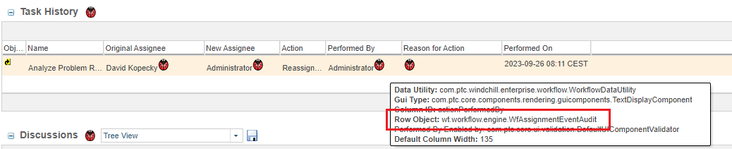

I am trying to create a report template that includes the "Performed On" value found under the Task History section. I was able to find actionPerformedOn under Property Report when looking up wt.workflow.work.WorkItem but cannot find actionPerformedOn when on the "Select or Constrain" tab when created a Report Template.

I am not sure if WfVotingEventAudit is the correct table. The property I am trying to capture can be found when looking at the Task page in Windchill. On the Task page there is a table called Task History; in this table there is a column named Performed On.

Can you show it ? just take a screenshot what you are looking for.

Hi @HelesicPetr, this is the property I am trying to capture. I think you are right with it being in wt.workflow.engine.WfAssignmentEventAudit.

additionally I use jcaDebug=1 for getting detail information about object in tables.
here is an article how to use it How to use "jcaDebug"
here is example how I found the table

Hi @HelesicPetr
Thank you so much for all the tips. The jcaDebug is an awesome tool! I was very frustrated and feeling unsure about developing future reports but this seeing this tool has me excited again.

It is wt.workflow.engine.WfAssignmentEventAudit
