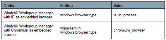

I want to change the embedded broswer as internet expolorer 32 bit. I have changed the wgmclient.ini but within the workgoup manager the borswer is act as 64 bit. Could you please tell me how can I change the brwoser within WGM?@

The only definitive statement I can find is, "The Workgroup Manager client uses the Internet Explorer version that is installed on the client machine."  (See page 7.)
The workgroup manager only lets you choose between the bundled Mozilla browser and the currently installed version of Internet Explorer.  It does not let you choose which version of Internet Explorer will start up (32 bit or 64 bit).

Many thanks for your reply. We are using the IE 32bit on the client machine, thats perfectly working well. But my question is with in the WGM , the browser should also work with IE 32 bit but its not. I don't know how to set this within the WGM. But I have set in the wgmclient.ini windows.browser.type: ie_in_process that is work well on the client machine. Within the work group manager the embedded browser is act as 64 bit. Do you have any idea how can I change this browser type? I should change only IE 32 bit because some of our security software compatible only IE 32 bit.

For Workgroup Manager, you need to use 32bit Workgroup Manager to use 32bit embedded browser. If you are using Windchill 10.2 M030, there is a workaround to install 32bit Workgroup Manager on 64bit Windows OS. Then the Workgroup Manager will use 32bit embedded browser. Although this workaround is not fully certified by PTC, there are customers who use this technique without issue.
