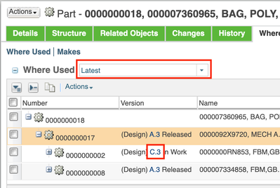

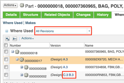

I am using Windchill 12.1.2 with the following API to fetch a two level where used for a part, however it is returning Version B (RELEASED) and C (INWORK) for the same part in the results. The results mimic what I see in the Windchill UI on the Where Used tab using the All Revisions view. I want my REST API to return the results as if the Latest view on the Where Used tab is selected. How do I do that in my REST API?
https://<wc_host>/Windchill/servlet/odata/ProdMgmt/Parts('OR:wt.part.WTPart:143038')?$select=Identity,State&$expand=UsedBy($count=true;$levels=2;$select=Identity,State)

Thank you for the suggestion, but I do not want to filter for only RELEASED state. I need the latest version. I want my REST API to return the same results as what is in the screenshot below of a Latest view Where Used.
The REST API , I posted above is returning the results that match an All Revisions view Where Used, see screenshot below. I DO NOT want that, I desire the Latest view results above.
