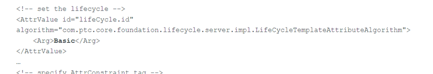

I referred below article and configured OIR according.
https://www.ptc.com/en/support/article/CS30088?source=search

It looks like I have found the cause.
In OIR, there is a default lifecycle template, When revise, Windchill will use default lifecycle template instead of keeping current lifecycle template.
<AttrValue id="lifeCycle.id" algorithm="com.ptc.core.foundation.lifecycle.server.impl.LifeCycleTemplateAttributeAlgorithm">
     <Arg>Developmental CC2 Lifecycle</Arg>
</AttrValue>
Is there any way to modify OIR ?
