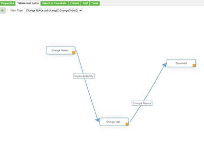

When you say objects in ECN  - do you mean Resulting Objects?
Maybe you can adapt the QML here: https://www.ptc.com/en/support/article/CS313295?source=search
You can get a count by using the database function "count". See: https://support.ptc.com/help/wnc/r12.1.1.0/en/index.html#page/Windchill_Help_Center/querybuilder/QBSelectOrConstrainDatabaseFunction.html
You'll need to put an argument for what to count. Below will count the number of Change Notices. You'll need to change it to be the objects on the ECN. The Persist Info.Object Identifier.Id attribute is really useful because it's distinct for each object.
