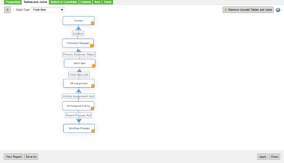

It looks like you want to report on Promotion Requests tasks. To show the state of the promotion request, you can join the "Work Item" to "Promotion Request", then add the State property from the Promotion Request. In my reporting, I like to see Context as well, and show "Context Name". Example:

For Task Name, take it from WF Assigned Activity - > Name
