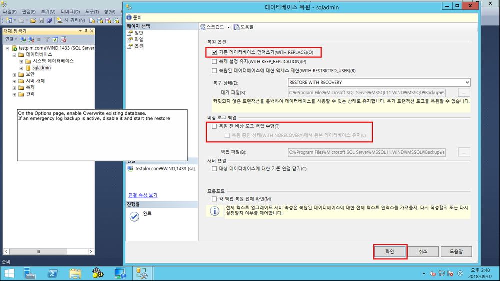

September 6, 2018
Currently, the following issues occurred when backing up and restoring databases from SQL Server 2008 to SQL Server 2012:
1. Warning when restoring * .bak file from 2008 in 2012
>> You can not perform a backup log because there is no current database backup
2. If you enable Restore after enabling overwrite in the Restore option, the restore will succeed but the method server will not run
>> Overwriting is judged to be due to the change of hostid
We will continue to review the migration of the database.
But if not, I will try the following:
1. CREO imports data from the old server.
2. Check in the data from CREO to the new server.
The above method may take longer, but it seems to be able to transfer data safely.

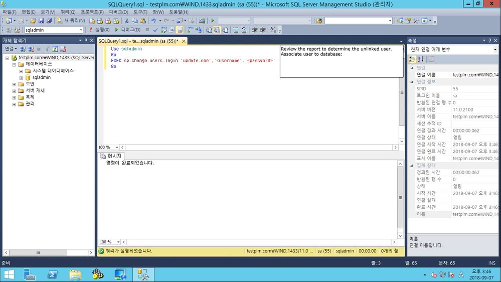

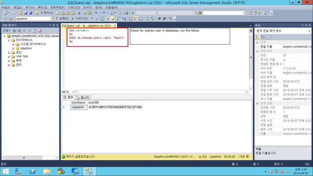

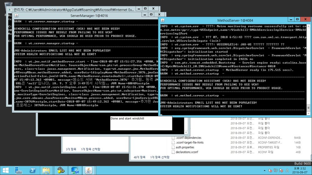

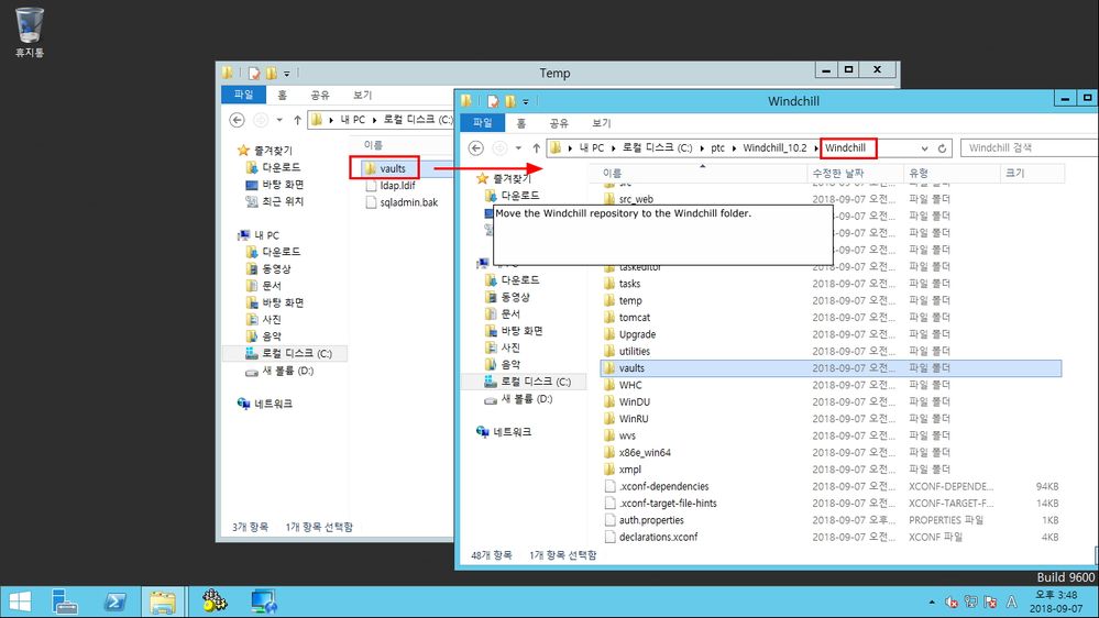

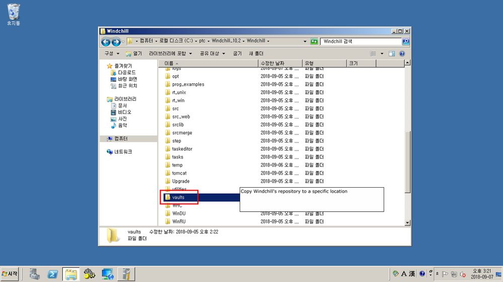

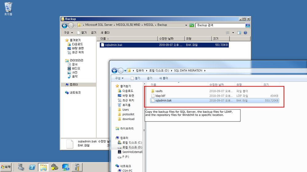

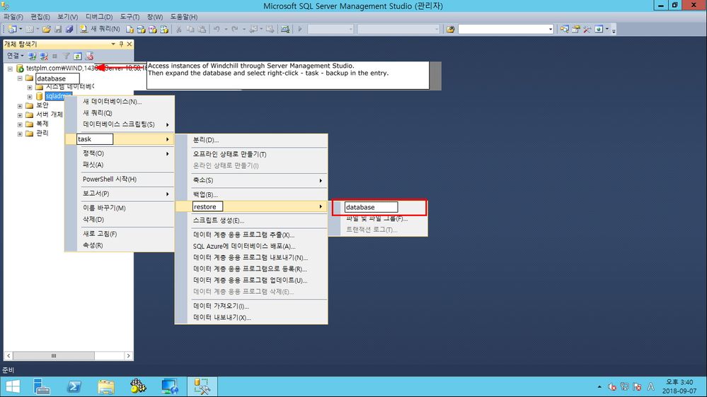

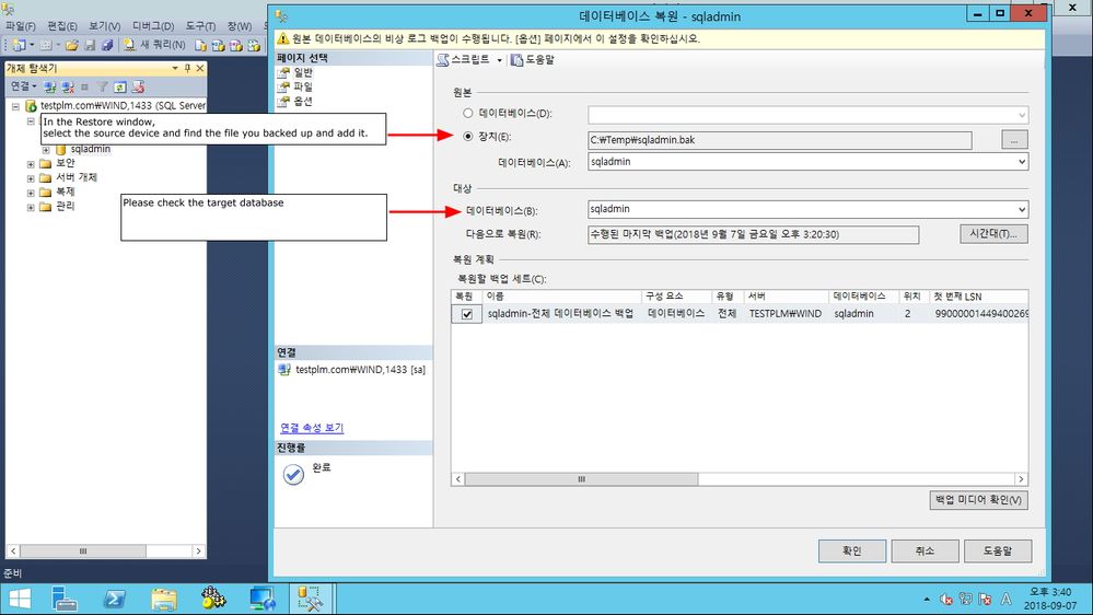

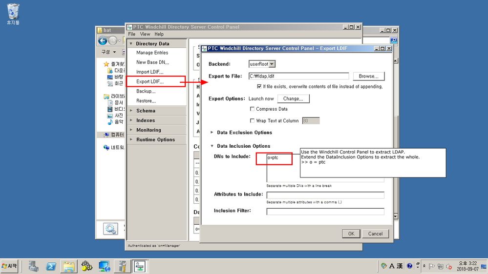

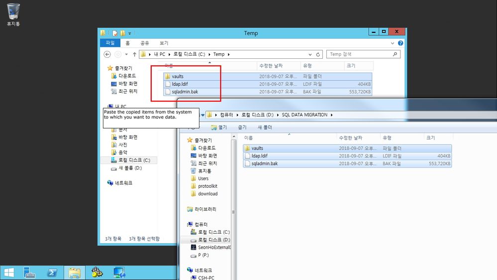

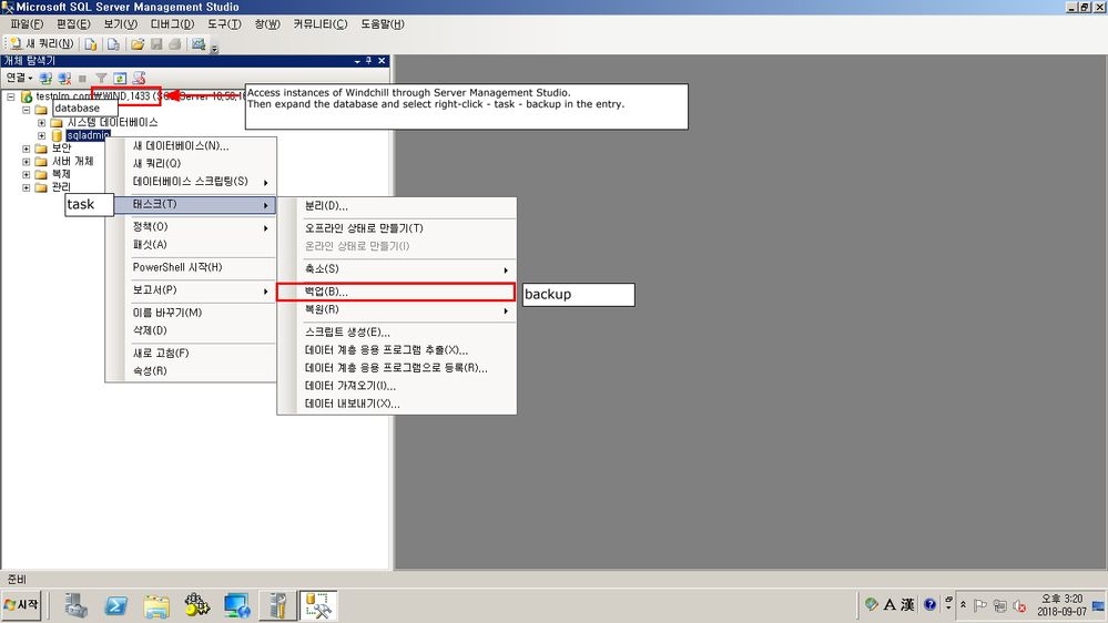

CHASEONHO18-OpalAuthorAnswer
18-Opal
September 7, 2018
I have completed migrating data from SQL 2008 to SQL 2012.
Here's how to transfer data.
Initial condition
Both the old and new servers have the same settings.
-DNS
-o = <ptc || org>
-SQL Server Intance [ex. WIND]
- Installation process and version, CPS version
We did not consider the sorting of the database.
Not Considered
The repository used only basic storage.
If you have used another repository, you will need to place that repository in the same path.
** It is recommended to back up the data of new server before all work.
** It is also recommended that you test your work environment after installing it on a virtual machine.
The data movement process.
Backup (old server)
1. SQL Server Backup
2. Store backup (copy)
3. LDAP backup
Restoration (new server)
1. Restoring LDAP
2. Restore SQL Server
During this process, we had to update the hostid table of existing data.
Oracle has related resources, but no SQL Server.
Therefore, we can skip updating the hostid table of existing data using the same DNS.
3. Restore (Paste) Storage
SQL Server moves the metadata.
Storage "vault" moves the actual data.
Restore Windchill users and policies in LDAP.
My test result is success.
Data, user information, and policy in the product and the product have been copied.
Thank you.
Warm Regards,
SeonHo
