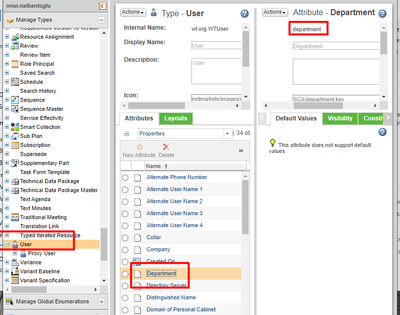

I see the user attributes that I pulled from LDAP in the participant and it works very well.
But I can't add these attributes to any form. For example, I select a user from the system with userpicker and I want to see the user attributes of this user.
How is it possible? Has anyone tried it before?

I've never tried, but did you add the new attributes to the User Info Page Layout?
(Click Layout tab -> select Info Page Layout -> add the attributes)

I believe the additional attributes are only available on the participant details page, but not accessible anywhere else.  Take a look at the steps in this article and see if it provides any clues:  https://www.ptc.com/en/support/article/cs162357
