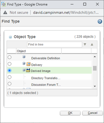

Policies on Representation can be set using "Derived Image" however this will affect ALL Reps not just the default Rep.  There is no OOTB way to limit it to just the default Rep.
Markups can be controlled using "Markup"
