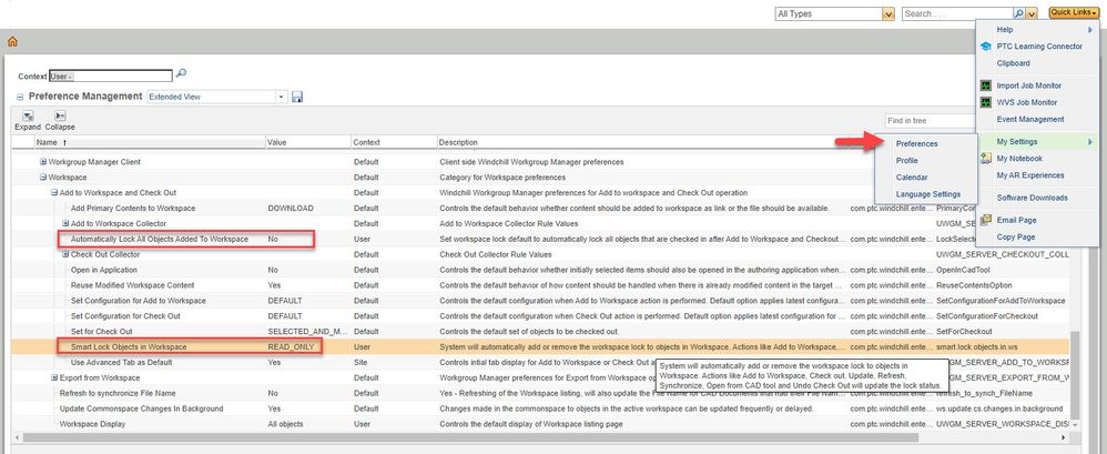

We've used workspace locking to help alleviate this problem for our Solidworks Windchill users. Locking also helps make objects read only in Solidworks to make people check out objects before starting their modifications rather then when they click save.
You can lock objects the workspace in several ways:
  • Manually from the Workspace using File>lock/unlock but this gets pretty tedious.
  • Use the Windchill preference to 'Automatically lock all objects added to workspace'. If in Solidworks, this requires users to unlock before checking out. Better but still tedious.
  • Use the newer Windchill preference 'Smart Lock Objects in Workspace'. This is probably the best option for Solidworks users. PTC keeps making enhancements to this. We're using READ_ONLY for Solidworks but the new ALL option in Windchill 12.1.0.0 could be interesting too.
You can set these preferences at the Org, Site, Context, or user level. We have our Solidworks users set it.
