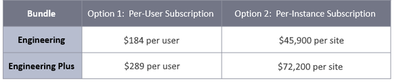

Anyone know how extension pricing works? I see this one, IHS Markit Synch, but unsure of its costs and price model? Is anyone using it and like it? I have asked for quotes on the IHS web services license which appears to be required too.

Hello @avillanueva
Generally you need to buy a bundle package to use the extension functions.
For example the IHS Markit Sync is under Engineering Plus
Hope this can help.
PetrH
