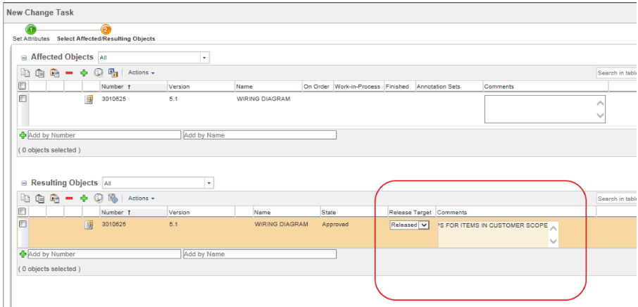

We use the comments field on New Change Tasks to write lengthy descriptions on each object that will be changed on the ECN.
Out of the box, this field is quite small and only displays a partial view of the text that is entered.  This makes it hard to proofread comments and view formatting.
Is there anyway to make this text box bigger so that more of the text is visible?

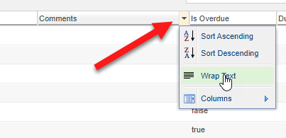

Don't know if you ever got helped, but Wrap Text is available and probably will solve your issue.  Select the pull down arrow on any column and select Wrap Text.

I believe @zgodula is talking about when editing the Task.  Not in one of the tables on the details page of the change.
I do not believe this can be done but this is one of my peeves about a change.  Why does PTC think that small box is all we need?
