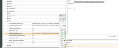

Use Case: I want to search the process plan by number using Windchill's global search
Description:
I already checked the optional attributes types for the search and the Process Plan is not there. Is there any way to add it, maybe through an xml file or something like that.image.png
Login to Windchill as Administrator> Site > Utilities > Preference Manager > Search > All Applicable Object Types Search > Add

Use this preference described here: https://www.ptc.com/en/support/article/CS383639?source=search
