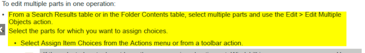

I am using Windchill PDMLink Release 12.1 and Datecode with CPS 12.1.2.2
How to assign choice for several parts in one action?
There is written:
1. select multiple parts and use the Edit >Edit Multiple Objects action;
2. select the parts for which you want to assign choices;
3. select Assign Item Choices from the Actions menu or from o toolbar action.
I'm stuck on the second point

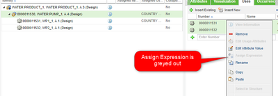

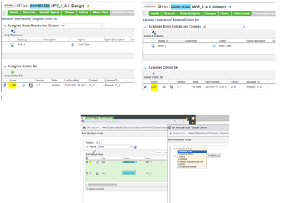

(To:Gucio)
Hi @Gucio
This wizard is used to define only part attributes, not assigning the options. Based on the help I may be wrong 😄
Or preference has to exist that allow you to edit the options in this wizard.
It can also be connected with correct license group that allows you to do it in the edit multiple parts wizard
Check the profile setting if there can be allowed this function or try to search in preference options.
In my case I can use assign expression from structure to set the option.

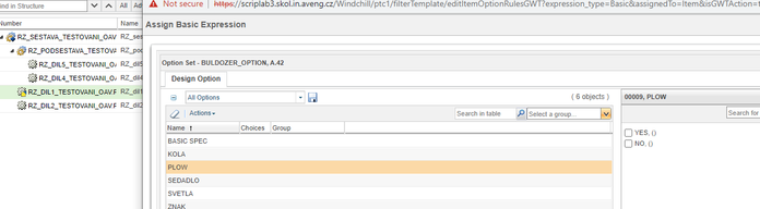

Gucio
(To:HelesicPetr)
PetrH,
you are right - this is the way how to assign choice to ONE part
If you select more parts - assign is not possible
But it is written that possibility of assigning choice for several parts in one action should be available
The document was created for Windchill 11.1 - should I treat this possibility as missed in 12.1??

Hi @Gucio
What license group is your user assigned?
There can be some license restrictions on that in the Multiple Edit Wizard
PetrH
Gucio
(To:HelesicPetr)
Hi PetrH,
user is added to PTC Smart Platforms License (Site) group.
Krzysztof

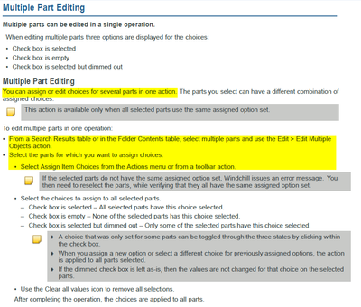

Fadel
(To:Gucio)
Hi , just check that wizard , such action don't exit OOTB in the edit multiple Wizard :
For bulk assigning expression, the only way is to use LoadFromFile , see https://support.ptc.com/help/wnc/r12.1.1.0/en/index.html#page/Windchill_Help_Center/WCDataLoadGuide/WCDataLoad_OptionsLoadFilesToUpdateOptionsAndChoices.html
Fede
HelesicPetr
(To:Fadel)
Hi @Fadel
So why the help contains wrong information?
PetrH
Fadel
(To:HelesicPetr)
Hello Petr,
glad to hear from you again , I think this info is from the PTC University, the Windchill Help Center has no such info :
https://support.ptc.com/help/wnc/r12.1.1.0/en/index.html#page/Windchill_Help_Center/parts/PMPartMultipleEdit.html  .
I'm not sure how to correct the PTC U documentation , for the Windchill Help Center we open Documentation's SPRs to R&D .
Fede
HelesicPetr
(To:Fadel)
Hi @Fadel
Oh I worked with the word "documentation" that I thought it is help page, ok it is really University Curse documentation. You know I can't read carefully 😄
