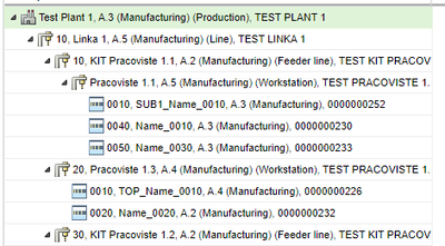

Use Case: Dear, I just want to build structure including operation on Plant structure tree such as the attached image. How should I do to make this?
Description:
Dear,
You can see the plant structure in left and also information was built with "0010" operation.

My additional critical point is how to make structure in 2nd image.
My main question is how to add " 0010, SUB1_Name~", "0040, Name_0010", " 0050, Name~" such as the below.
I cannot add them into the below Work Center or Workstation?
Test Plant
 - 10, Linka
   - 10, KIT Pracovisite
      - Pracoviste
         0010, SUB1_Name
         0040, Name_0010,
         0050, Name
 - 20, Pracoviste
    - 0010, TOP_Name
    - 0020, Name_0020

Your structure does not have the Process Plan object yet.
Usual hierarchy(Structure) is to have Process Plan > Operations.
The Tools / Work centres are not technically in the structure, but by special relation that goes by "Work Centre allocation".
The Roll up of the work centres are the Assembly lines and finally the Plant itself.
Basically, you have 2 different (but inter related) structures, one representing the Plant>WorkCentre>Tool hierarchy
and the other is the Process Plan>Operations. (Operations will have a non-structure link to Work centre, tools, resources, Control Characteristics etc.,)
This is how Windchill's take on the Process plan and Facilities.

Did you review attached image?  You can see the operation “0010 ~~”. I believe this is operation from process plan.
You can take a look at this feature in the below, especially 11:50 ~. 12:05.
https://youtu.be/lzdyIO-kjVA?si=nJZdiqzZNACvLR2h
I’d like to know how it is possible.
Thx

I dont think you actually assemble the "Plant" Structure. In the exact portion of the video , the demo shows "Open in Related Plant". So its a contextualized resulting structure.
The hierarchy is usually PP > OP and the OP are having resources and Work centres. The Work centres parallelly roll up to a Plant.
Did you try to recreate the demo in OOTB system (only the plant portion).

I did try to create the plant structure and I could make the below
Plant - Work Center - Work Center - Equipment/Jig
                                                                - Part
But I couldn't make such as the below
Plant - Work Center - Work Station - Operation
                                                                - Workstation
I want to configure structure the attachment but I couldn't add the Operation. 0010, Assemble Bracket (might include resource & part).
In the movie I can take a look at whole assemble sequence on Visualization by Playback Actions.
But I couldn't configure structure similar with movie and I couldn't play operation such as movie 11:50 ~ 12:05 on Related Plant.
Ie, in the movie I can see Process Plan Structure and open "Open in related Plant" .
And then I can see the assemble sequence with Playback Actions icon. But I cannot do this. This is exactly my question.
Thanks a lot.
If you need to do a non-OOTB relationship model like this one., ( I think the Video has done that).
                                                                - Workstation
Then go to the Type and Attribute manager , and go to the Type Workstation and add the Type "Operation" as one of its allowed Child Relations in the tab "Relationship Constraint".
There will be the OOTB relationship constraint for Workstation like Tools, Resources..etc.
Check it out.

Hi @DamienL
In the video, there is the main point that you have to open the plant in the related plant structure, and this function is different then just open the plant and go to the structure..
It is opened from the process plan structure.
You have to configure the process plan with plant and assign a WorkCentre's from the plant to the operations .
Then use the Open in Related Plant and the actual structure with operations will be shown.
This way It works.
but I had an issue that the structure was not shown at all. So You should refresh the explorer and then open the related plant.
PetrH

You can just add the operation under an another operation. and assign the WorkCentre to that operations
