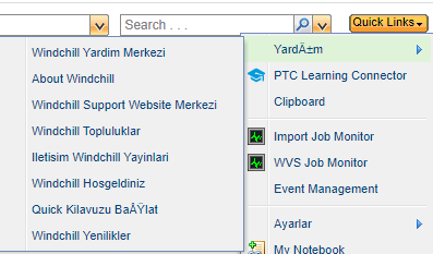

I'm trying to make my windchillda menus in Turkish, but it doesn't read Turkish characters. I added encoding utf-8 to navigation xml files, but it didn't work. How else can I do?

I want to make the quick links part and the navbar part in Turkish. It does not read Turkish characters such as "ı", "ş", "ğ"

Ha, so you use the RBInfo definition. It is very important information.
In that definition you have to use different character definition. The correct one is UNICODE. It is not encoding of file it is definition of characters.
So you need to find UNICODE definition of your language characters and use it in you source files.
my example is:
so instead of "á" I use "\u00E1" and so on...
PS> your characters unicode-table
PetrH
Turkish characters:
ğ => \u011f
Ğ => \u011e
ı => \u0131
İ => \u0130
ö => \u00f6
Ö => \u00d6
ü => \u00fc
Ü => \u00dc
ş => \u015f
Ş => \u015e
ç => \u00e7
Ç => \u00c7
