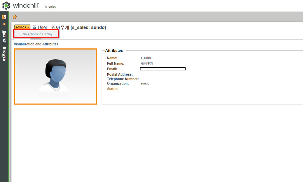

Why can not I edit if I go through my profile in the quick link's profile?
How do I make it possible for users to change their own settings?

Hello CHASEONHO
Yo can canage the preference under
Quick Links > My settings > Preferences
Only Windchill administrators have the acess to modify the profile , You can contact your windchill Admin to update your E mail adress
Regards
Gagan D
Instead of Profile, they will pick the Preferences option right above it. They will only be able to change Preferences they have access to.
