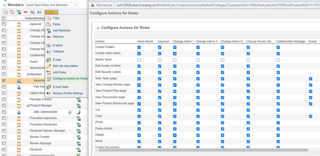

Hi @OnurNalbantoglu
Try to do so from context / product / library team
There you can change the profile setting based on the roles of the context.
Can not find any better way now.

Hi @OnurNalbantoglu
PetrH
I did what you said and it worked. thank you.
