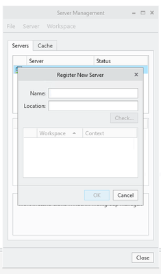

How doe we register the url in server management and use basic authentication instead of SSO?

with this i see it based on each publishing application. WIll i be able to register the server in the server management within workgroup manager?
For unattended publishing - you don't register the server in server management. It will register the server upon each publish job using either auth.properties basic auth, auth.properties $user variable auth, or Client Credentials Grant auth. If you are doing something interactively on the publisher (troubleshooting, checking connectivity etc.) you would register the server in Creo using your interactive login via SAML. If you are doing this interactively, you will need to make sure to unregister the server when you are done because this could cause issues (Creo will try and login on startup with the server registered - interfering with WVS unattended authentication.
