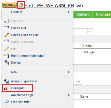

You need good option and variant definition.
The WTPart needs to be set as a configuration module
A Option set needs to be assigned to the WTPart
Then you can find configuration button in the action menu
This button opens the configuration Wizard

Hello @HelesicPetr ,
Thank you for your response. I had already tried the way you provided, but it was creating standard Variant Specification where I do not see the Modules tab in the Structure tab. Since I want to explore the capability of Modules tab, I want to create a Variant Spec which would have that tab,
