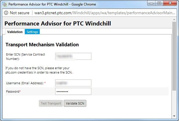

  5. Login as Site Administrator and navigate to Site > Utilities > System Configuration Collector and Click Performance Advisor for Windchill button. The Performance Advisor for PTC Windchill window will open. 31.jpg
  7. Click Test Transport to verify that the Performance Advisor can communicate with PTC.

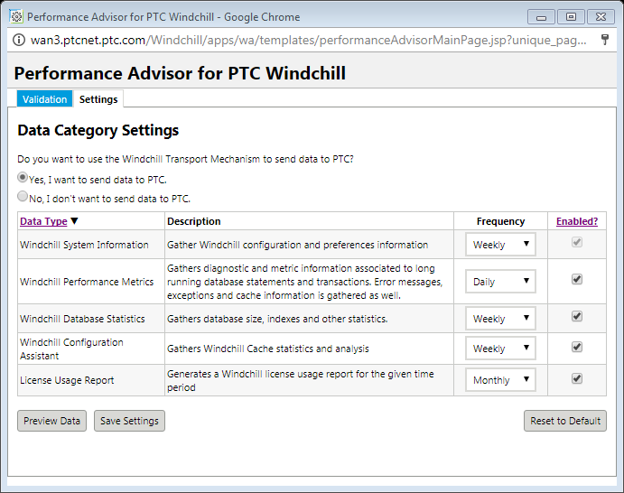

  8. On the Settings tab, click Yes, I want to send data to PTC, and Click Save Settings to save the changes made to the Settings. 33.png
Refer “Configuring Performance Advisor for PTC Windchill” guide in patch for any additional details.
