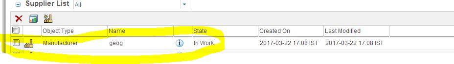

I want to fetch the Manufacturer /Vendor Organization for a Manufacturer part. I am able to get the Manf./Vendor part. I want to fetch the Contact details of the Supplier, for which I will need to fetch the supplier organization. Need Help. Thanks.
