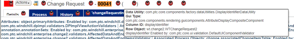

Hi, I am trying to add a column to a custom report that collects Task data. The new column will show the highlighted number (in this example: "00041") in the task name/description.
The debug says this field is ColumnID: "displayIdentifier" coming from Row Object: wt.change2.WTChangerRequest2.
Is this number only available in the ChangeRequest2 table?

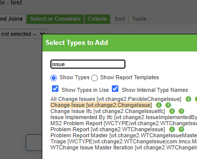

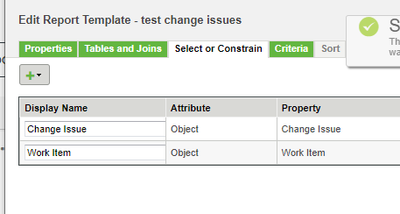

Change Request, Change Notice, Problem Report and others are all subtypes of the Change Issue type.  In QB, you can link a Work Item table to a Change Issue table.
cheers -- Rick

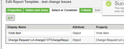

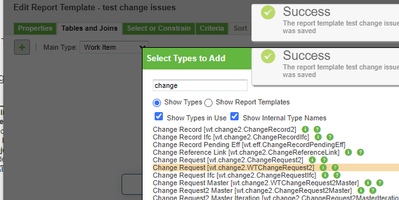

Yes, the Primary Business Object can be used with ChangeIssues to see all Variances and PR's in your workflows.
A different case: link CR's to Work Items. Remove the ChangeIssue above, and link to ChangeRequest instead
This shows every CR that is involved with a  workflow. Likewise you could link with ChangeActivity
